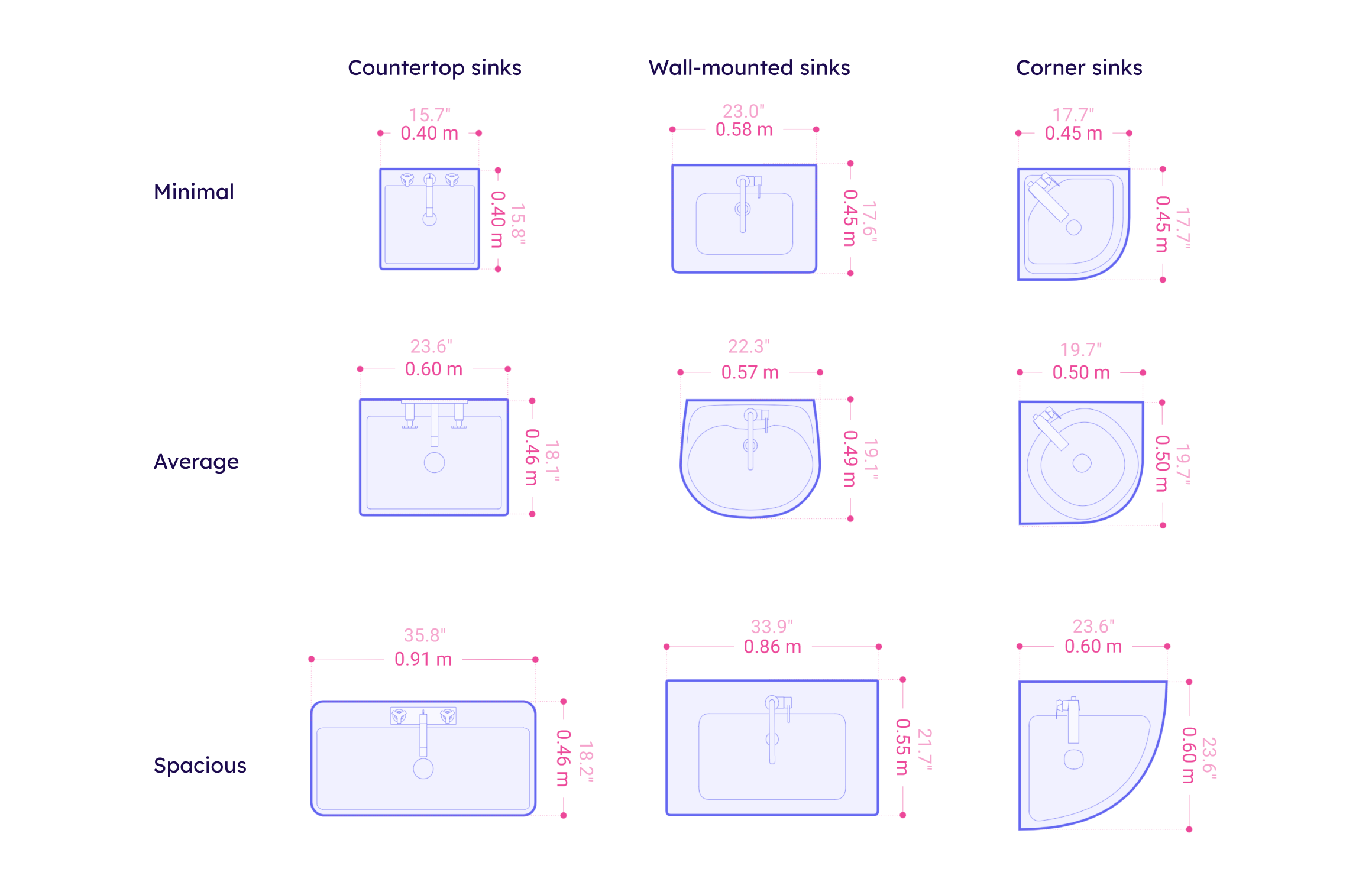

Sink Dimensions
Sink dimensions and typologies vary widely:
  • Countertop sink sizes range between 40x40 cm / 15.7"x15.7" to 46x91 cm / 18.1"x35.8"
  • Wall-mounted sinks range between 25x40 cm / 9.8"x15.7" to 35x60 cm / 14.2"x23.6"
  • Corner sinks range between 45x45 cm / 17.7"x17.7" to 60x60 cm / 23.6"x23.6"

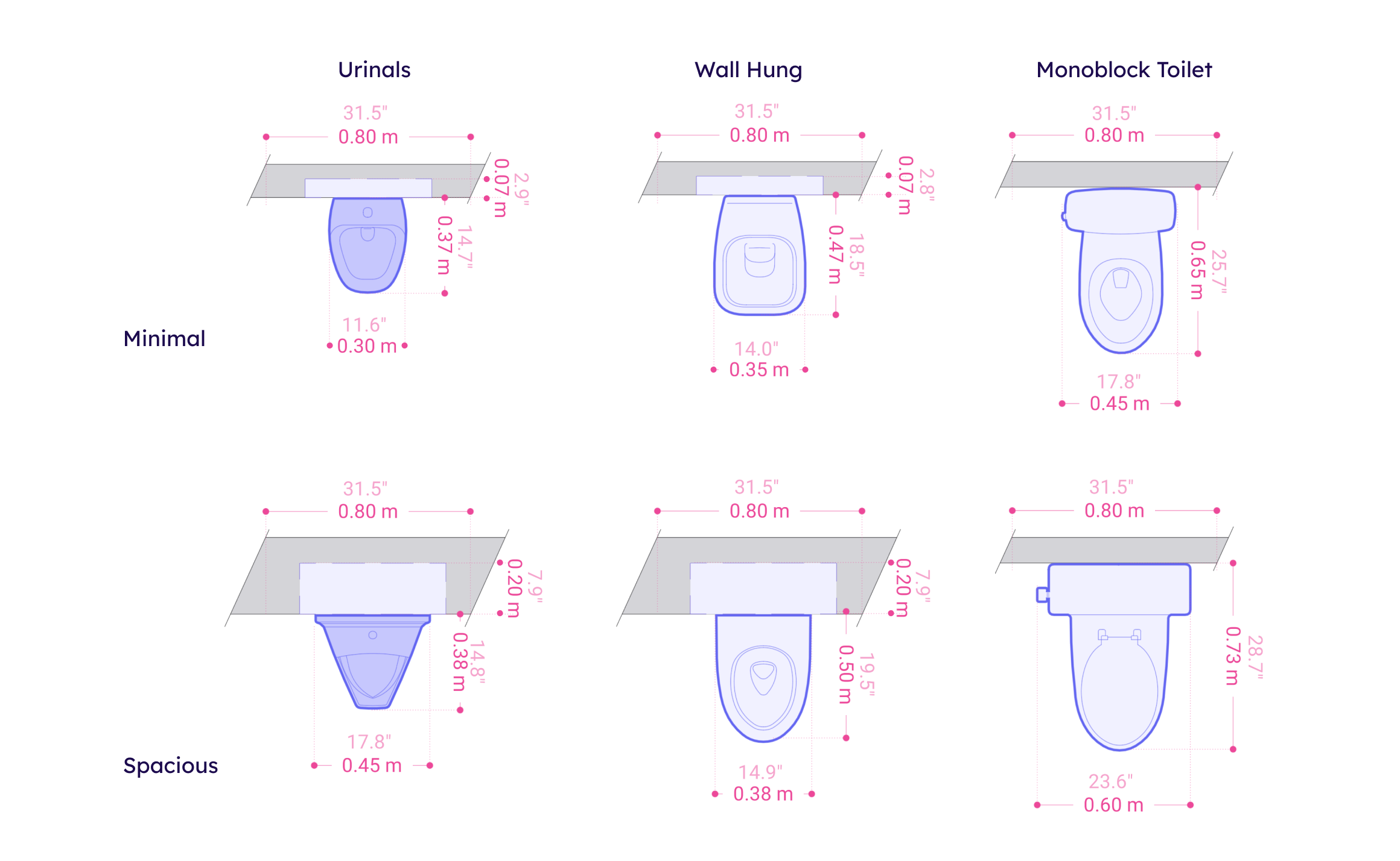

Toilet & Urinal Dimensions
Public toilet and urinal sizes vary depending on the design and manufacturer.
  • monoblock toilet size is roughly 75x60 cm / 29.5"x23.6".
  • floating toilet size is approximately 35x50 cm / 13.8"x19.7", and a floating urinal size is 38x40 cm / 15.0"x15.7". In both cases, a basin is installed in the wall behind it that ranges between 7-20 cm / 2.8"-7.9".
  • The toilet should always be centralized in an 80 cm / 31.5" clearance space for comfortable use.

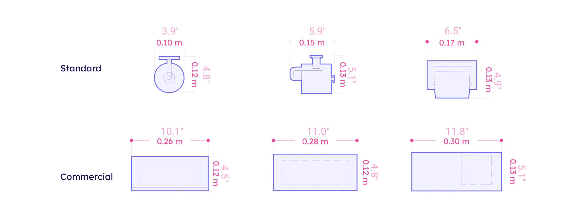

Toilet Paper Holder Dimensions
The size of a toilet paper holder is between 10x12 cm / 3.9"x4.7" and 30x13 cm / 11.8"x5.1".

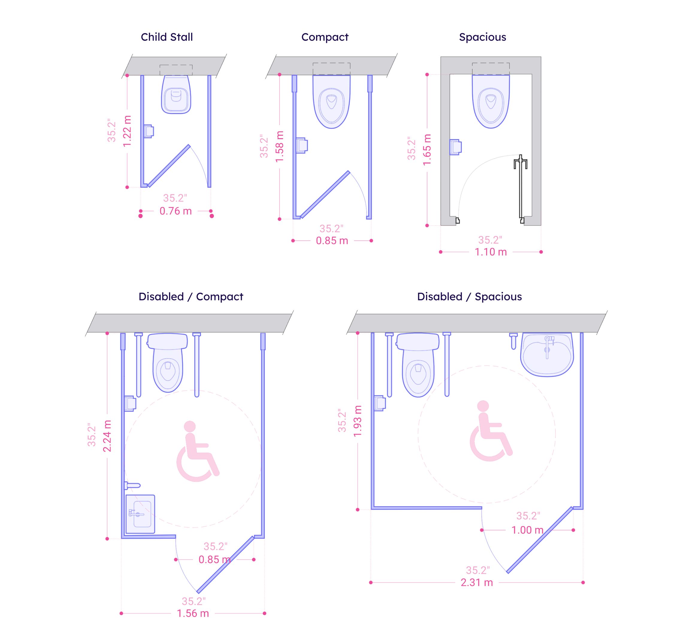

Toilet Stall Dimensions
Dimensions of standard and accessible toilet stalls depend on local building codes and requirements; follow those closely or consult an expert to get them right!
  • A benchmark compact public toilet stall is 80x155 cm / 31.5"x61.0", and a spacious one can reach 90x160 cm / 35.4"x63.0".
  • Accessible toilet stalls range from 150x220 cm / 59.9"x86.6" to 225x190 cm / 88.6"x74.8" and require a minimum of 150 cm / 59.1" floor space radius to allow for the maneuverability of a wheelchair.
  • Note that toilet stalls can be constructed using different types of partitions, which affect the total sqm. Thin partitions make for a compact stall, while walls are possible in a more spacious area.

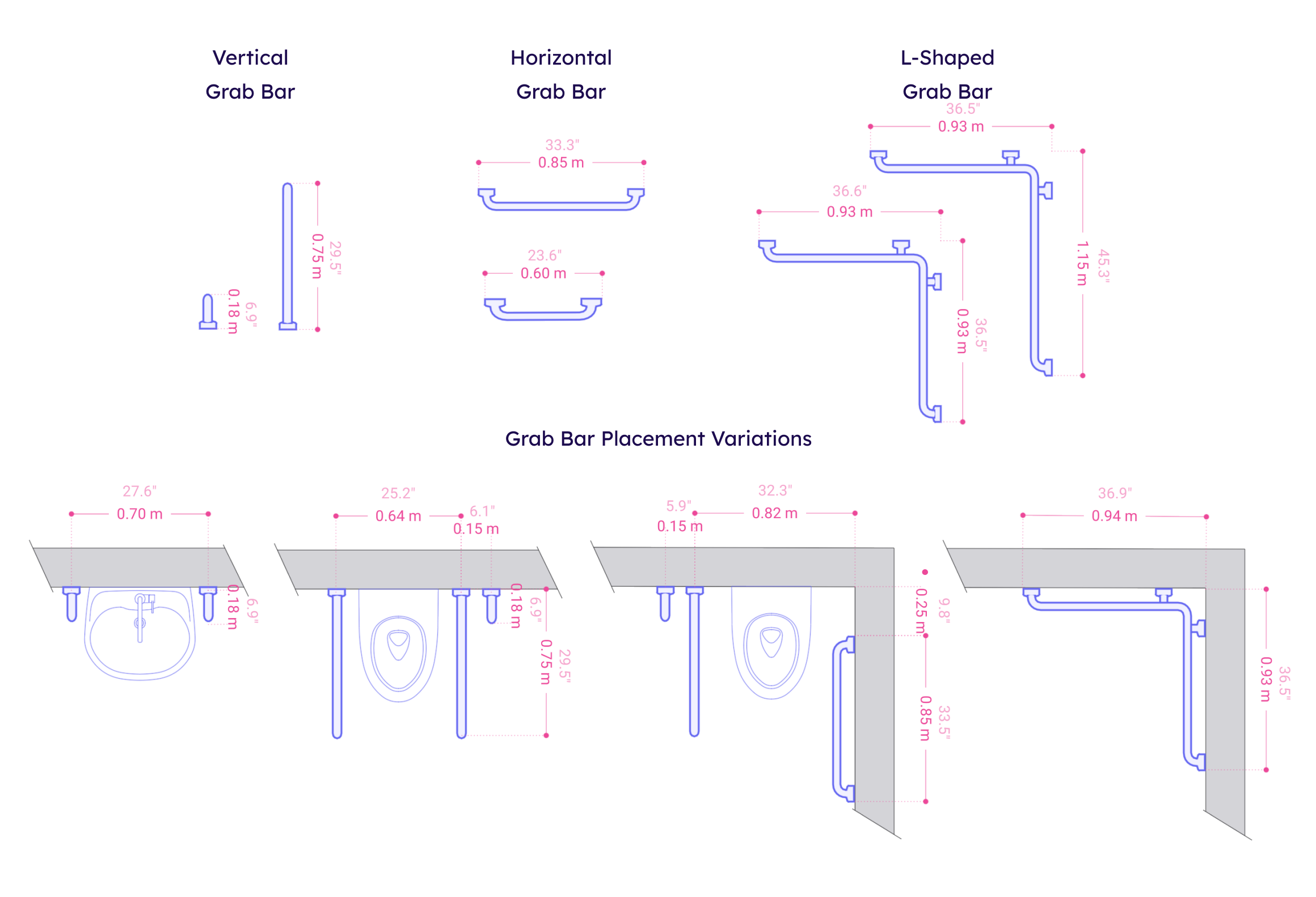

Accessible Toilet Grab Bar Dimensions
Dimensions of accessible toilet grab bars depend on local building codes and requirements. Not That:
  • Grab bars should be installed in an accessible stall on both sides of a toilet, sink, and shower.
  • Vertical grab bars come in a 15 cm / 5.9" typology and a 75 cm / 29.5" typology.
  • Horizontal grab bars vary between 60-85 cm / 23.6"x33.5".
  • L-shaped shower grab bars are approximately 93x110 cm / 36.6"x43.3".
