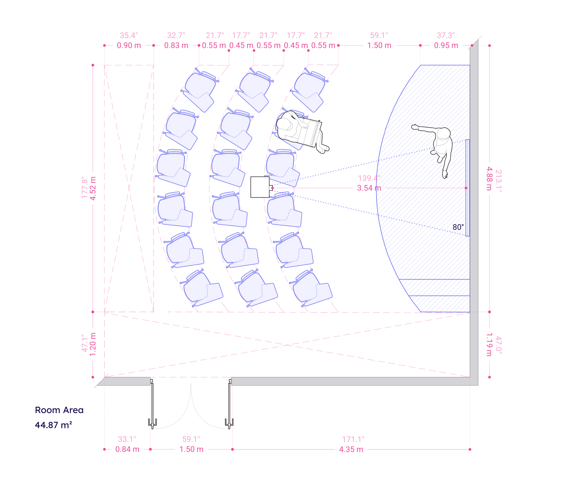

Round Seating Auditorium
Auditoriums are used for training sessions, workshops, seminars, and other educational events. A round auditorium seating arrangement provides a comfortable viewing experience of a stage. Some benchmark dimensions for this layout typology are:
- Spacing between chairs: between 45-50 cm /. 17.7"-19.7"
- Circulation around seats: between 90 -150 cm / 35.4"-59/1".
- A wheelchair is equivalent to the space of two chairs.

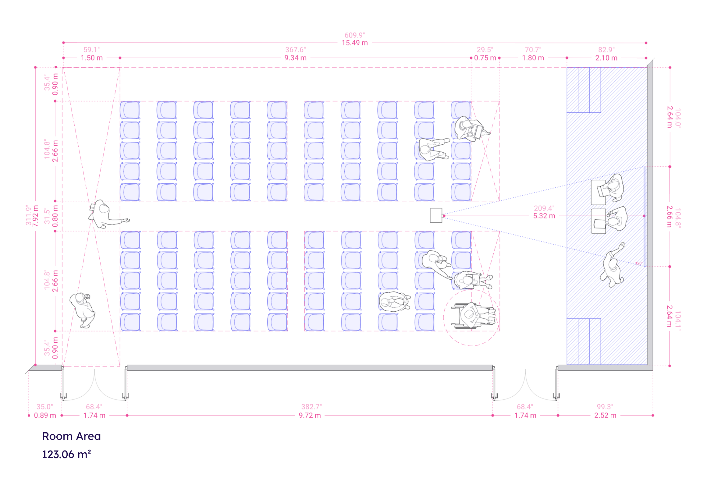

Multi-Aisle Rectangle Seating
Fifty-seat auditoriums require a multi-aisle arrangement and are commonly found in mid-sized companies or organizations. They are suitable for presentations, conferences, or seminars. Some benchmark dimensions for this layout typology are:
